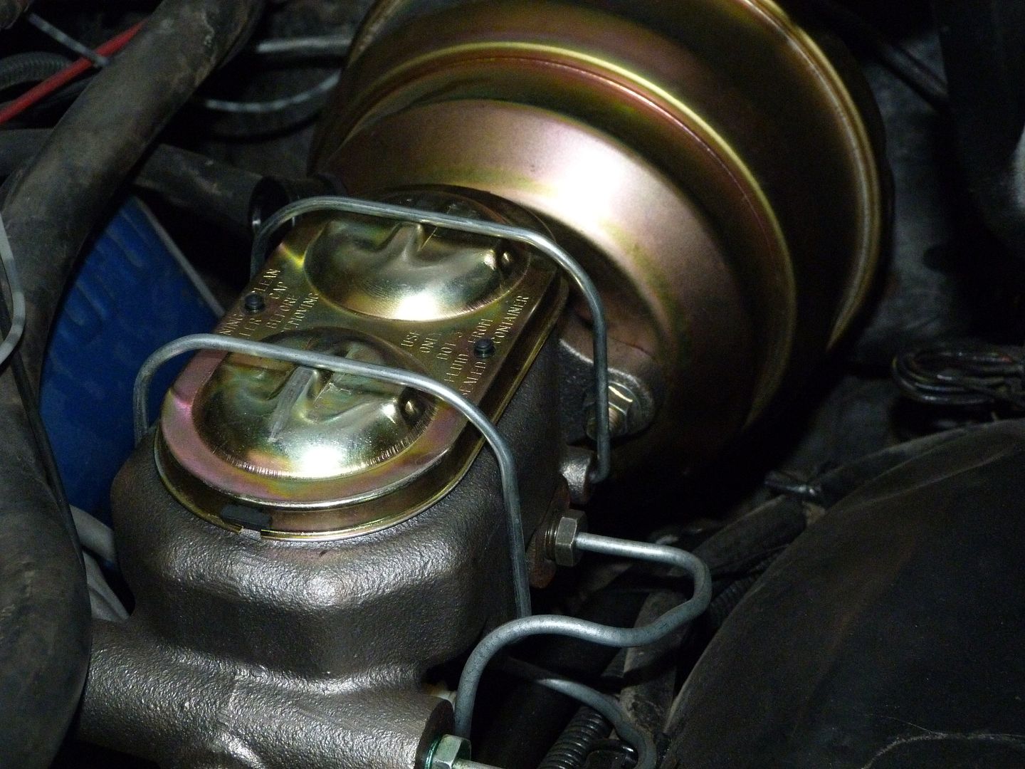

New power (disc) brake booster, (disc) master cylinder, and hand-bent brake lines to all 4 wheels.

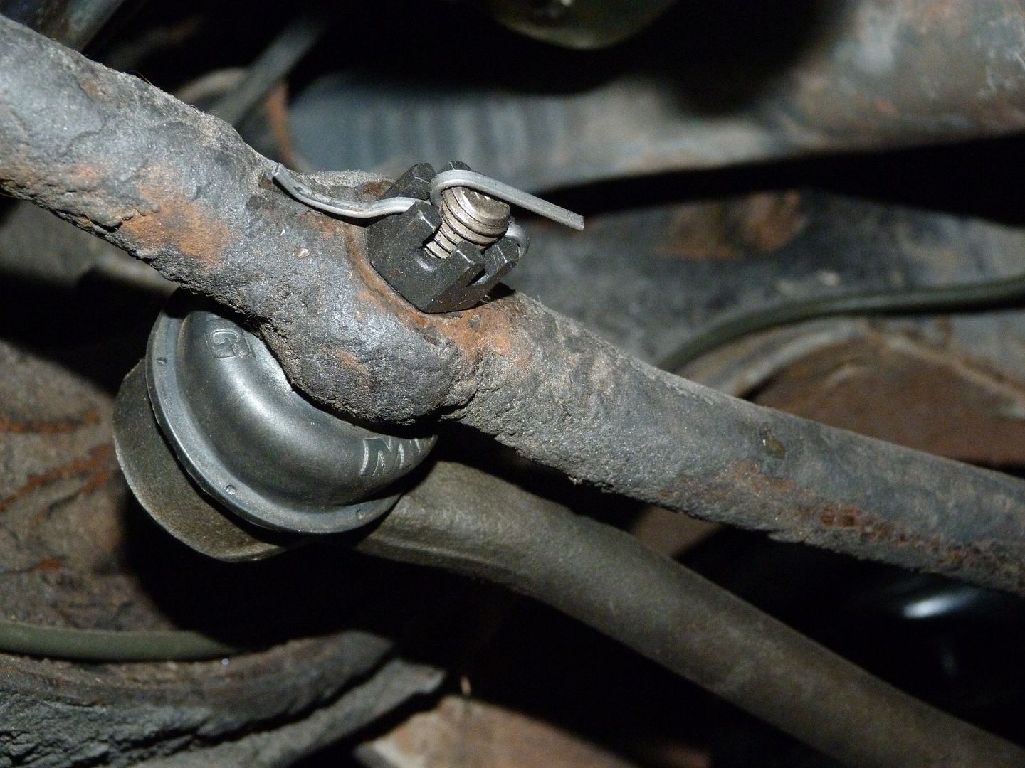

New polymer Sway bar bushings. In fact though not singled out for comment, the entire front end has new bushings and bearings, visible in other photos.

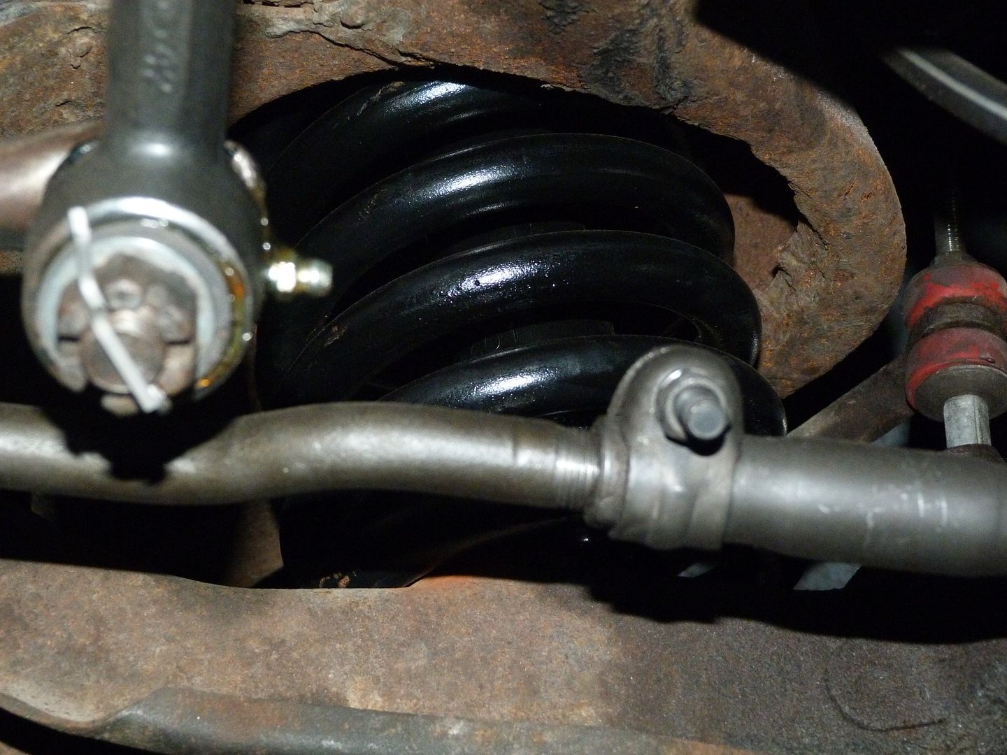

Shot of one new custom front spring.

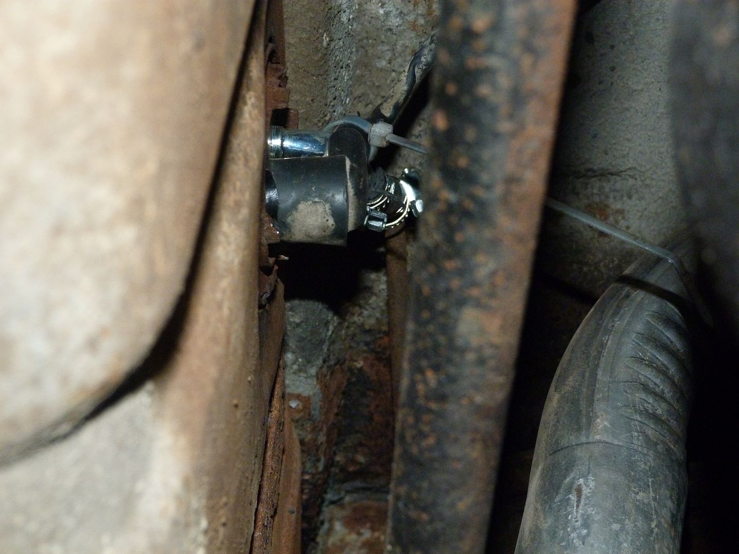

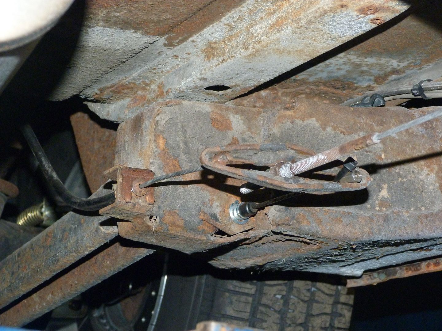

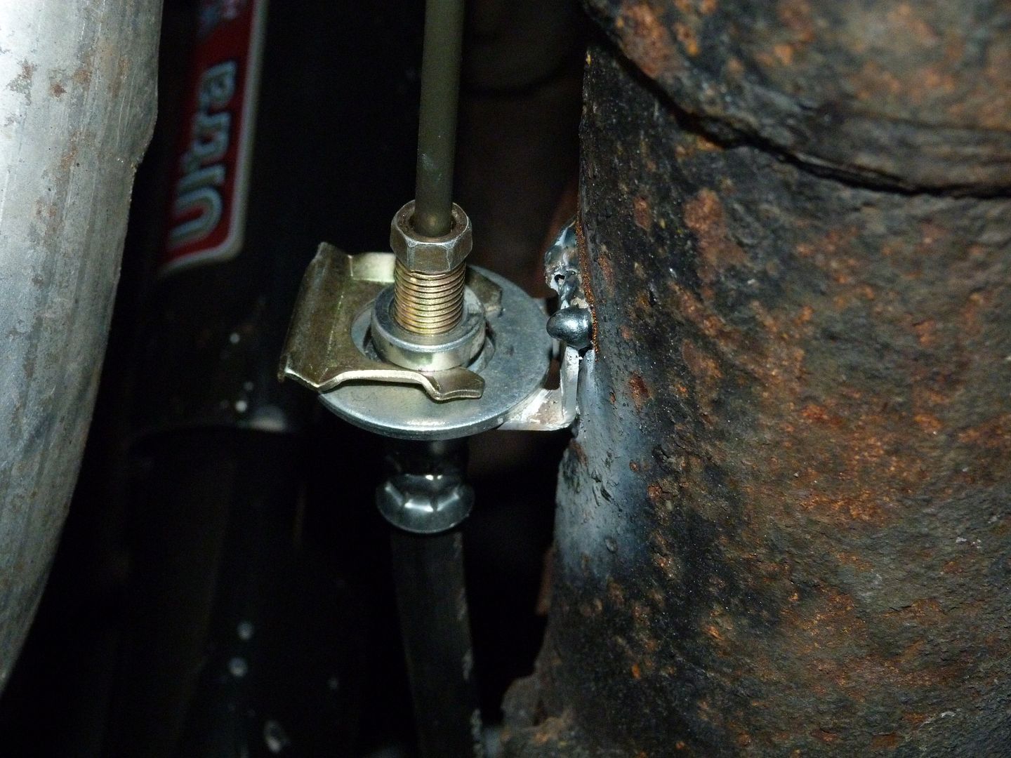

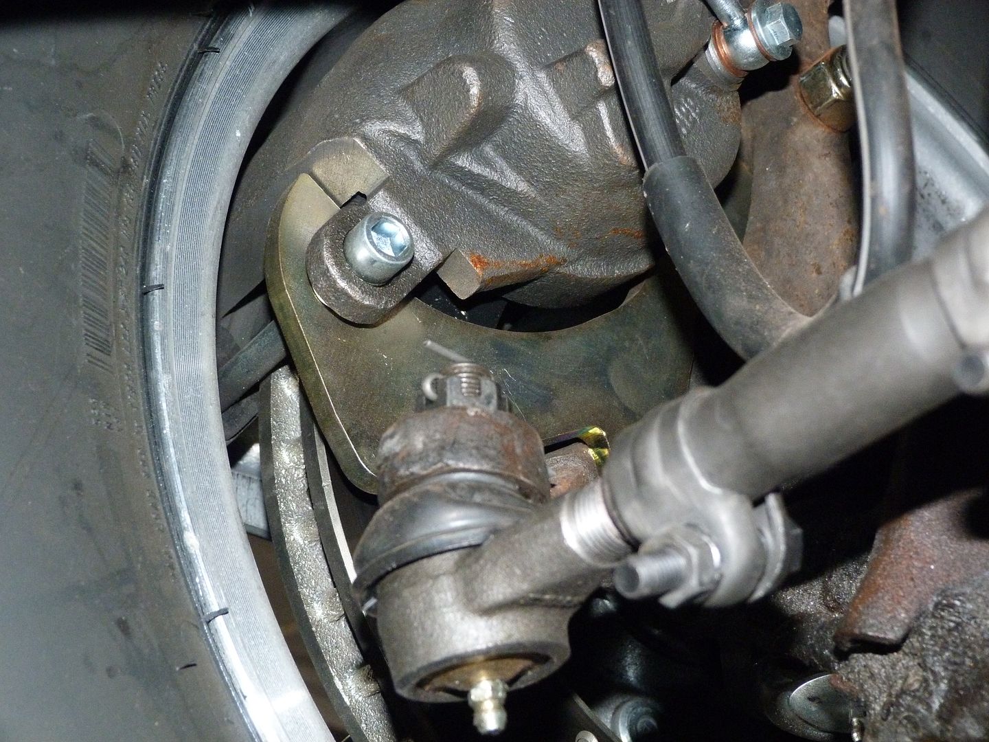

New bracket for emergency brake cable to discs. Required for disc conversion from drums.
Left rear disc brake set up with new "ultra" shocks
Right rear disc brake set up.
Another emergency brake fitting added.
Part of new E-brake system.

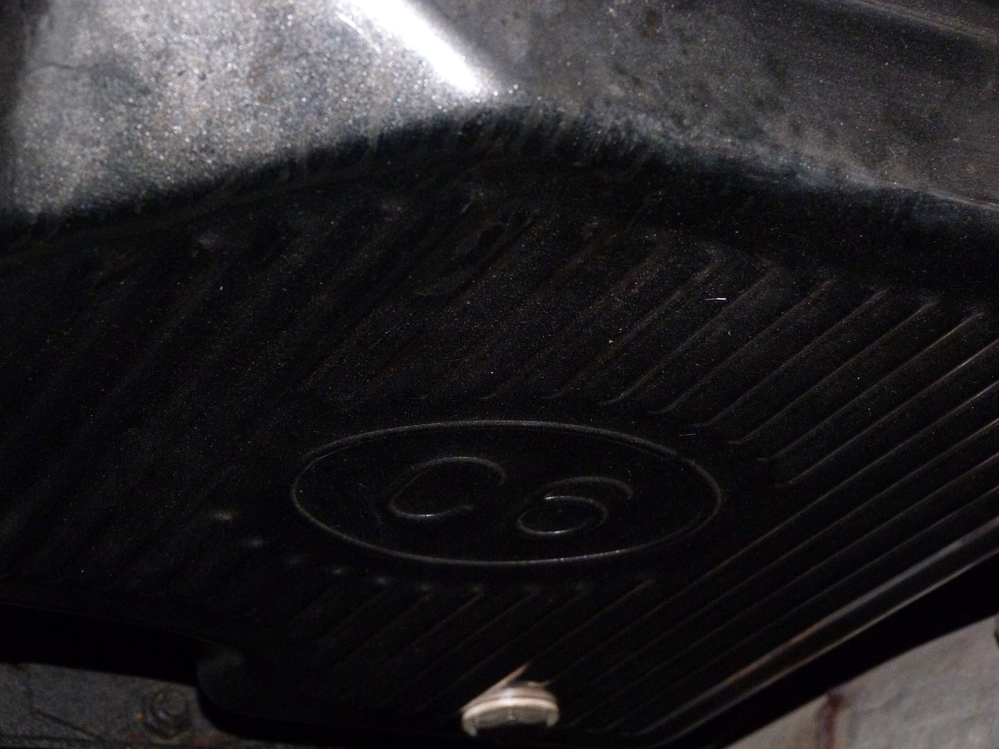

C6 Auto trans with new 3500 rpm stall converter and shift kit.

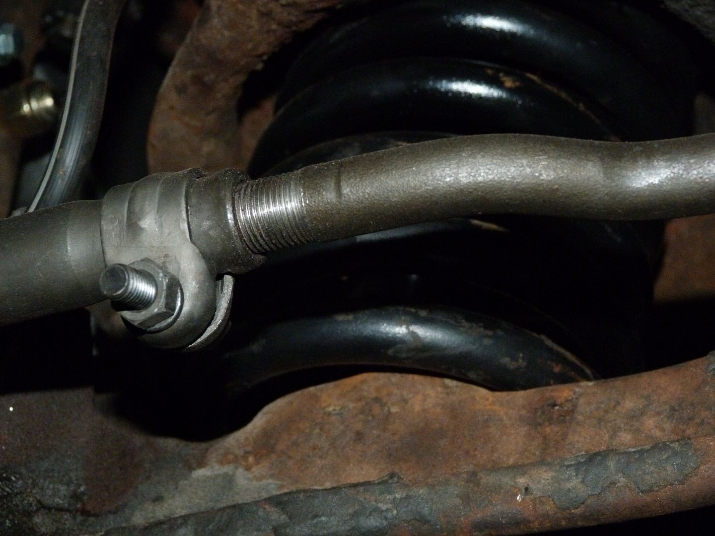

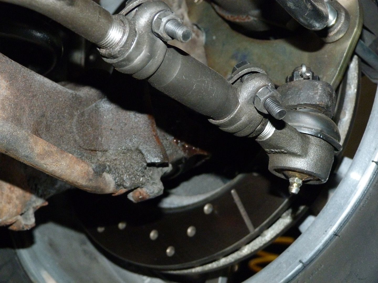

Right front suspension showing new parts like Idler arms, Pittman arms, upper and lower ball joints, A-arm bushings, and sway bar bushings.
Right front suspension showing new parts like Idler arms, Pittman arms, upper and lower ball joints, A-arm bushings, and sway bar bushings. New custom spring. Front disc brake set up with new calipers and lines.

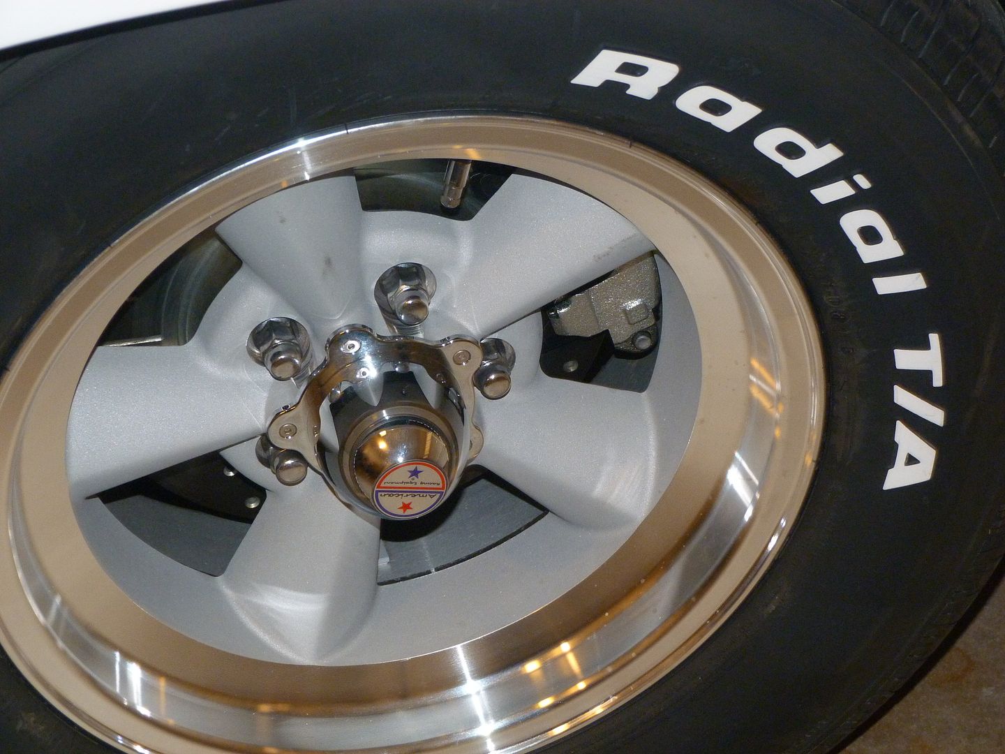

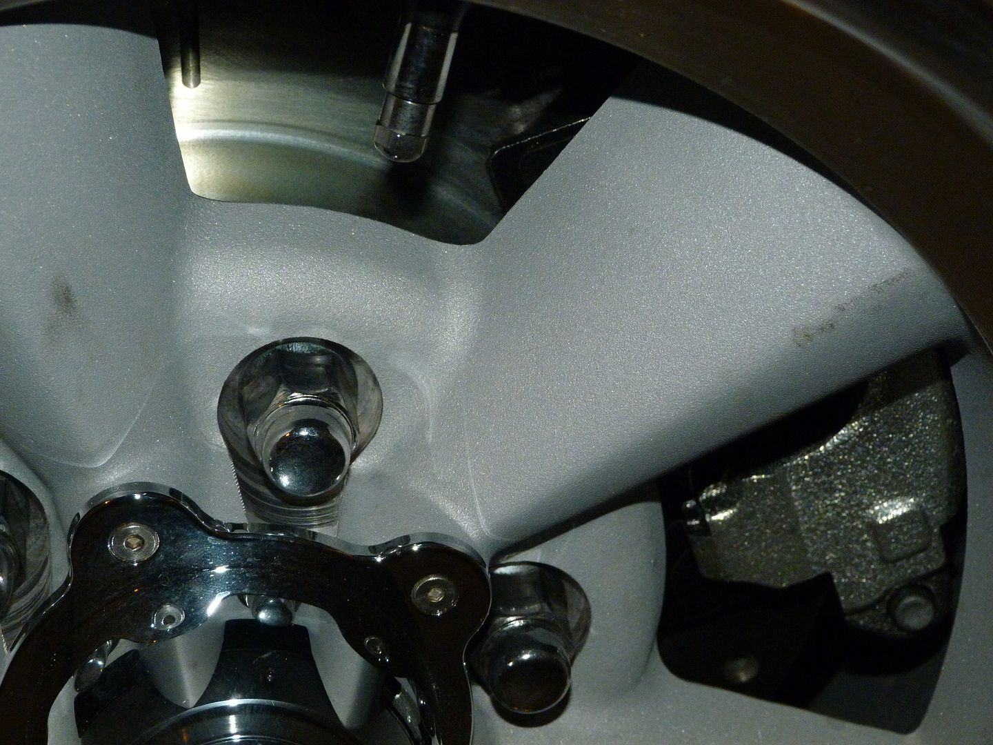

She sure looks good. Can't wait to get more done. You can see the new calipers through the new American Racing Torque Thrust wheels.
New rear wheel with discs and calipers.
New front wheel with discs and calipers.

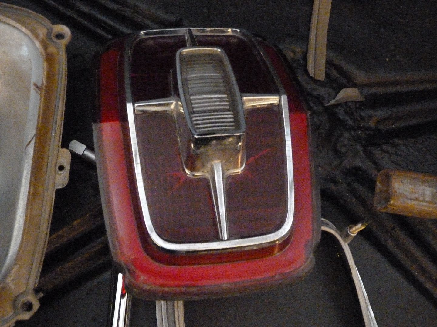

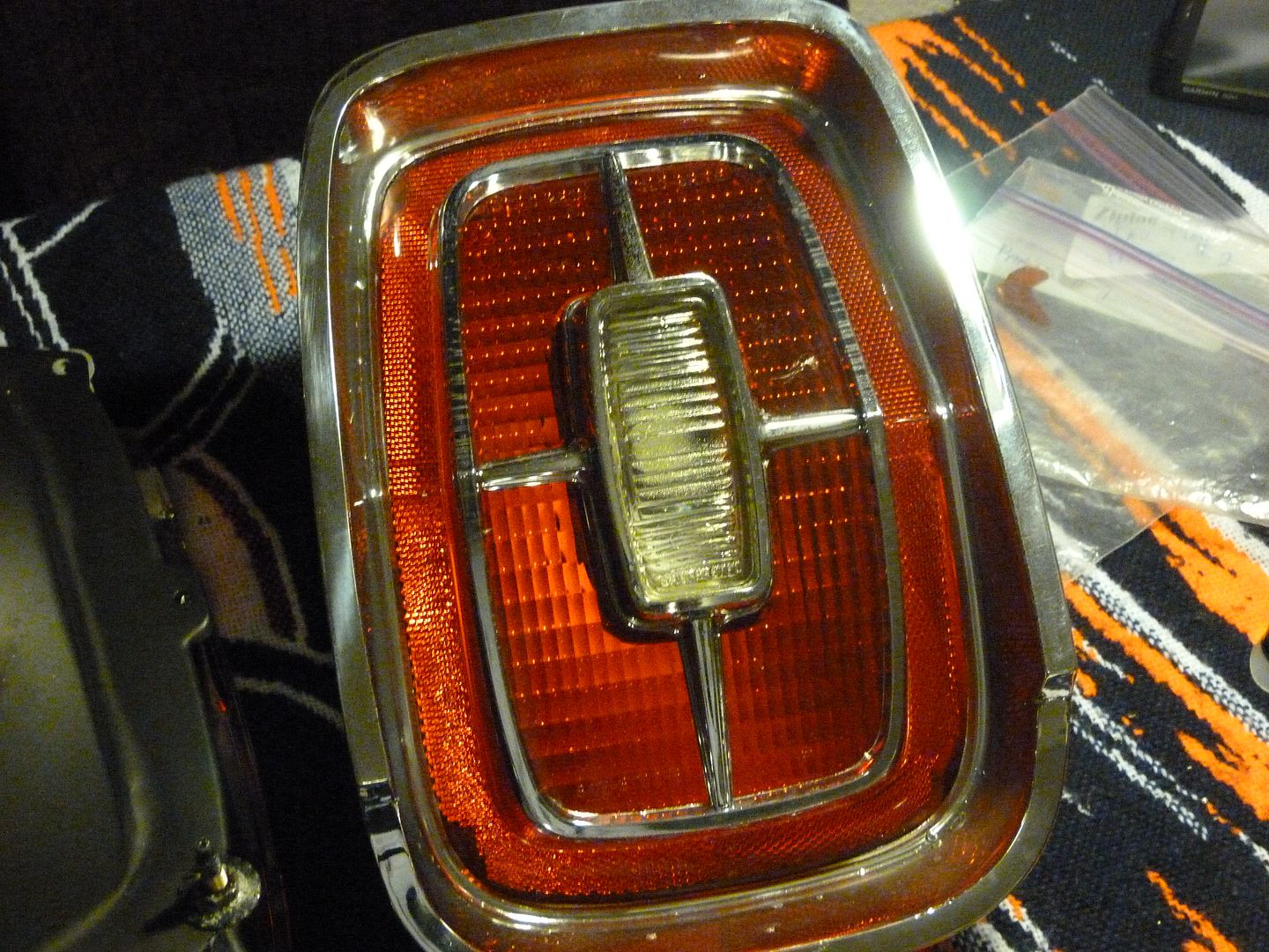

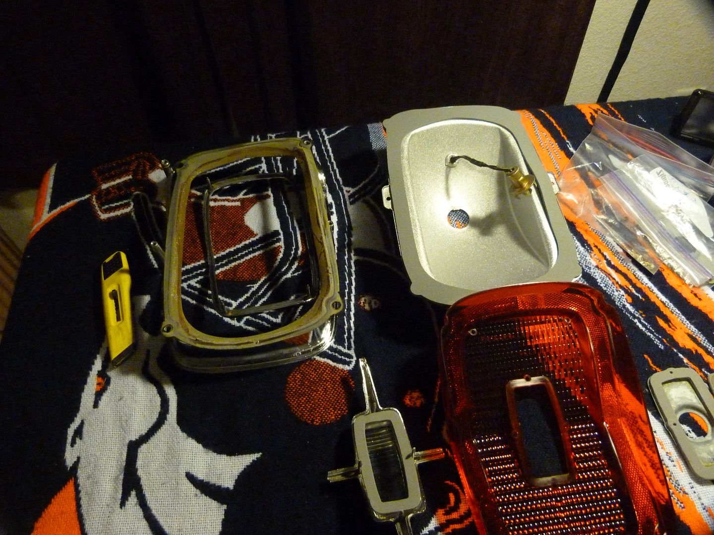

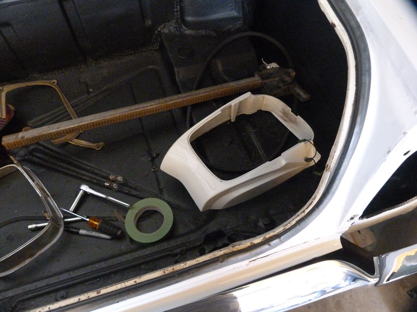

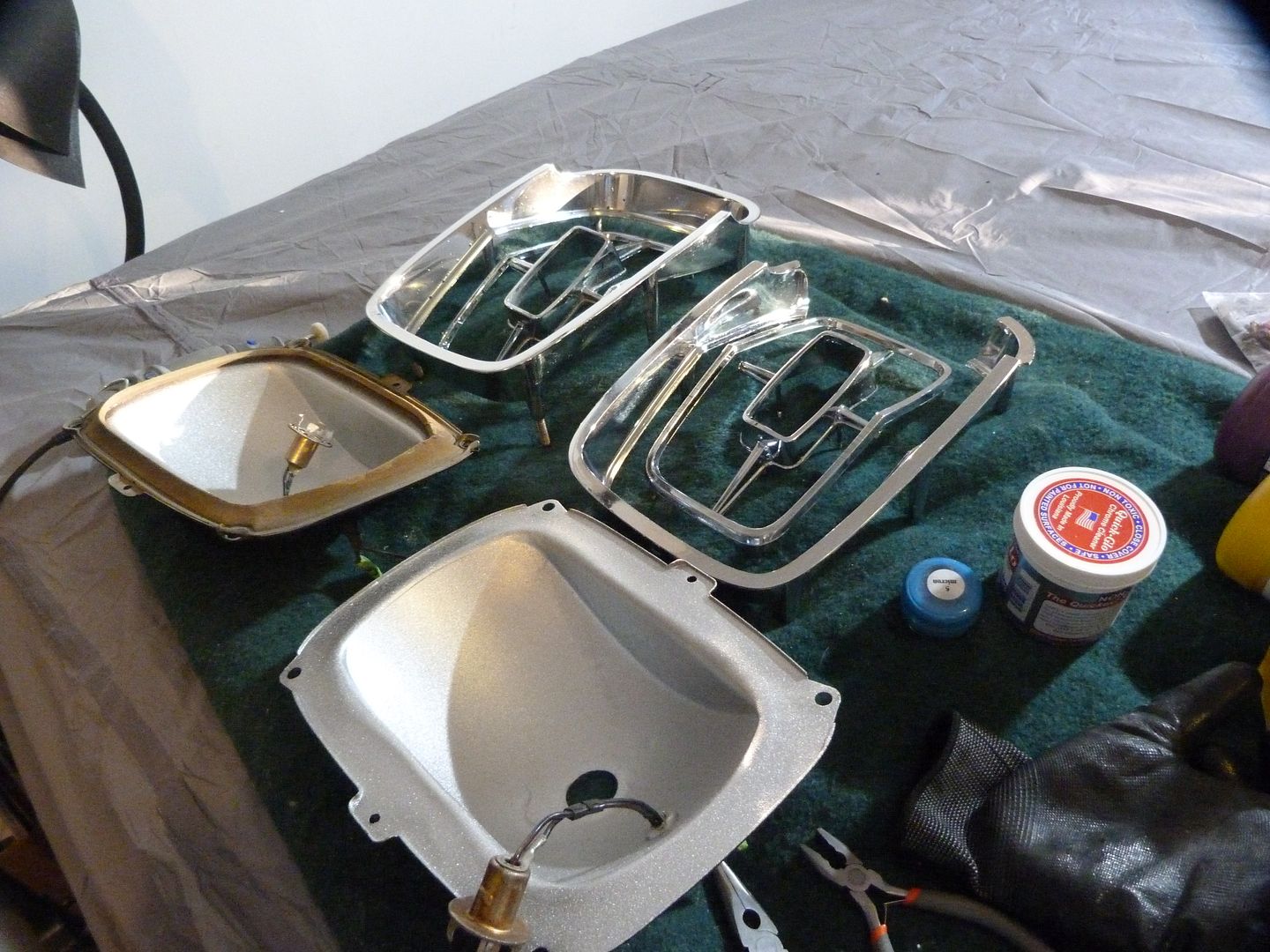

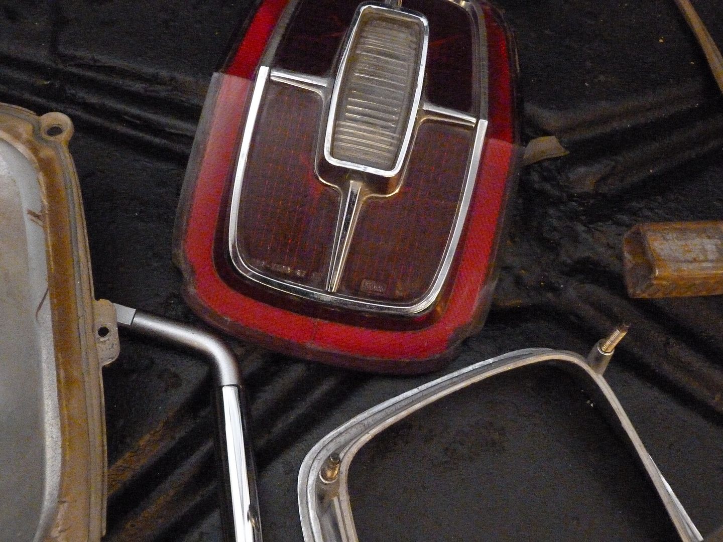

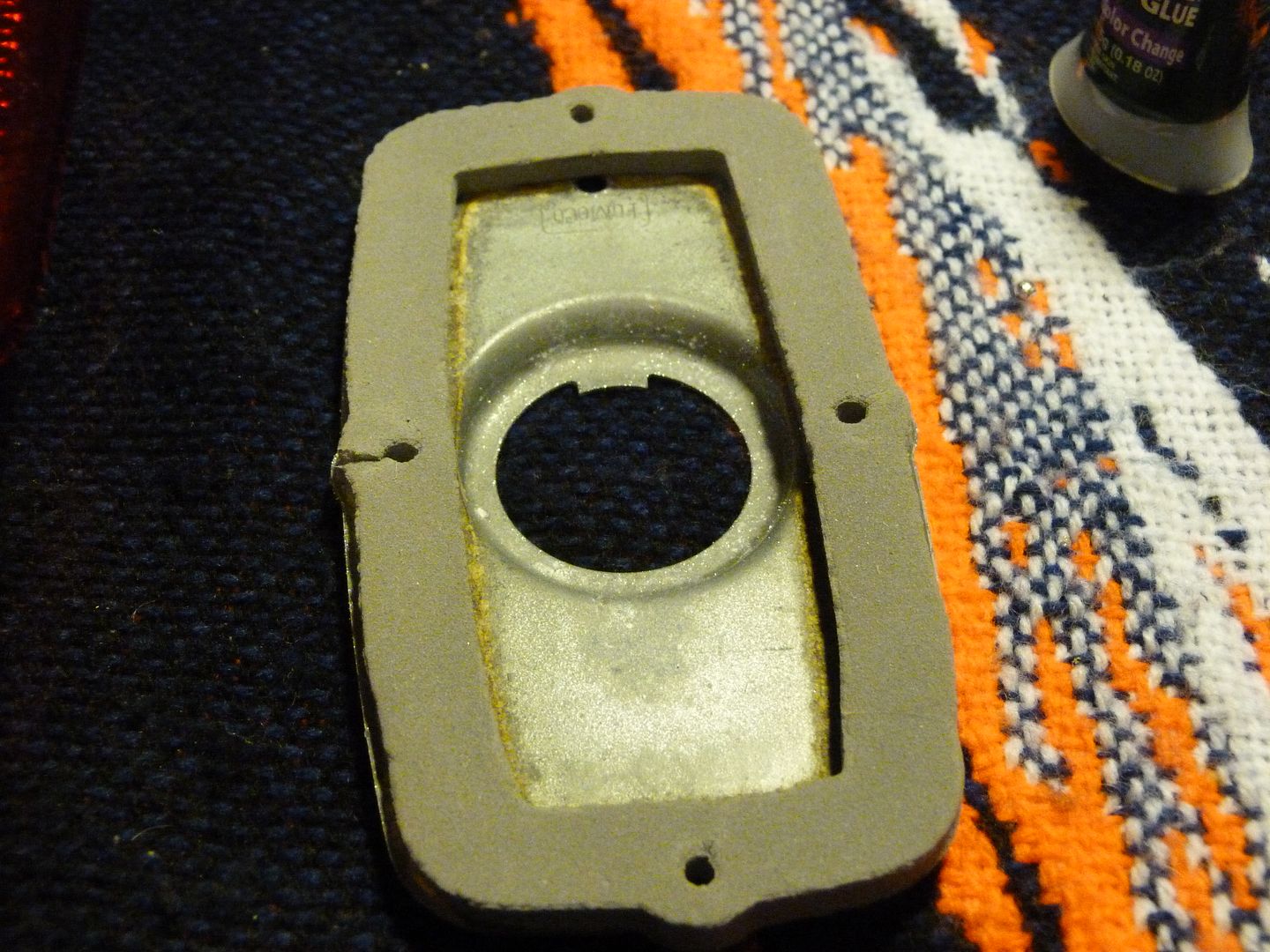

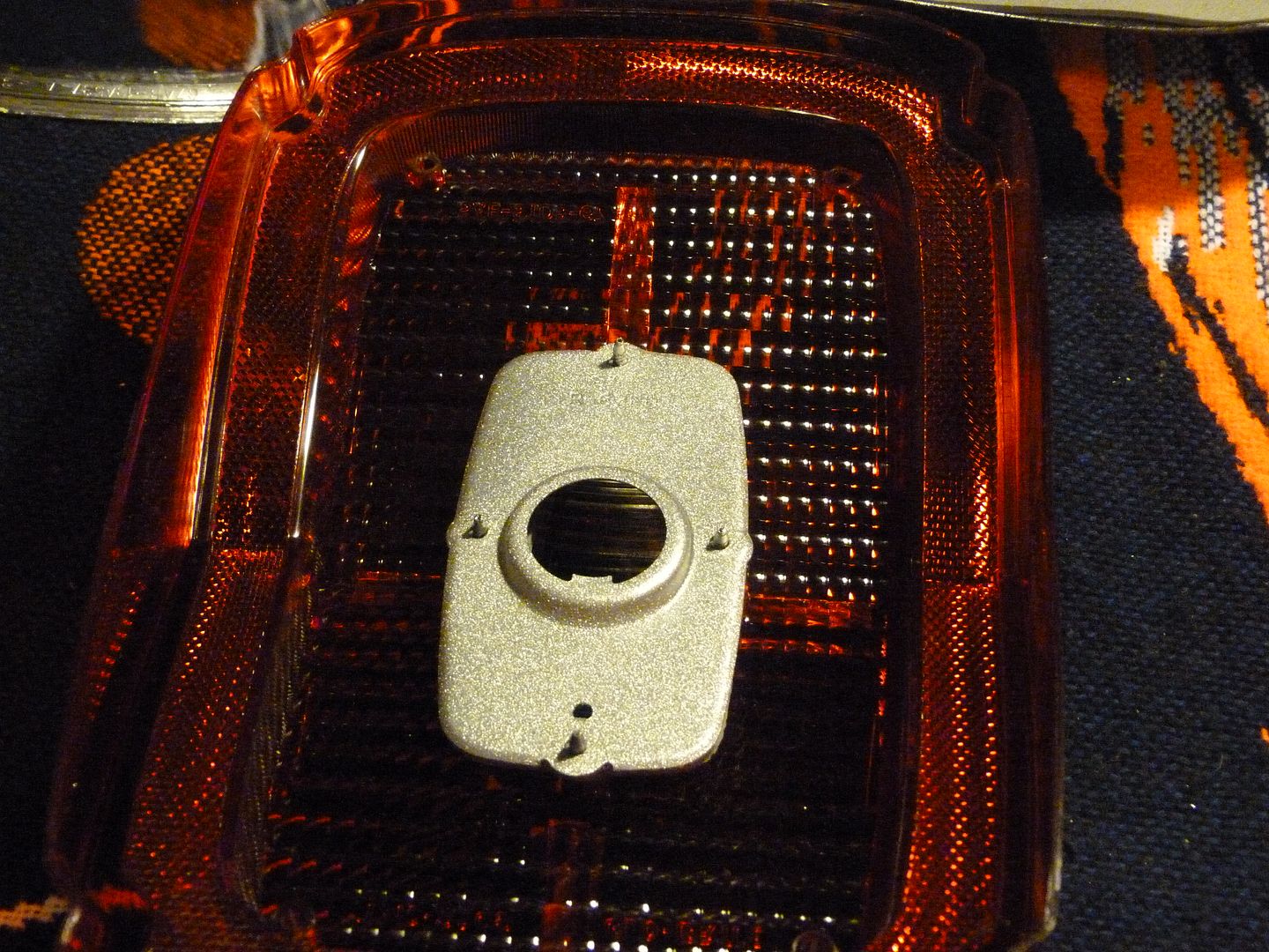

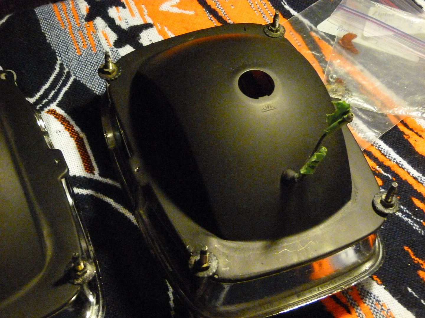

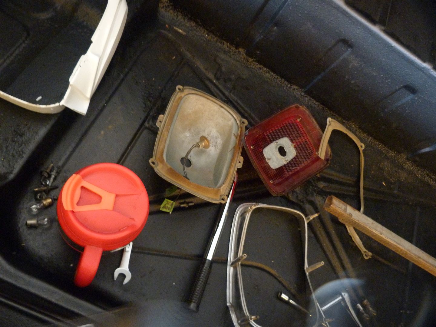

I am working on the rear taillights of Galaxie. I removed the assemblies from car. Outside body color housing. Inner reflector assy. Lens assembly with accents. Old style backup light bulbs replaced with white 60 segment LEDs with 110 lumens. Center clear lens. Old style brake/turn lights replaced with 52 segment RED LEDs with 90 lumens. Red lens. With new "silvered" reflector surfaces this will be a GIANT step up in performance.
Left removed.

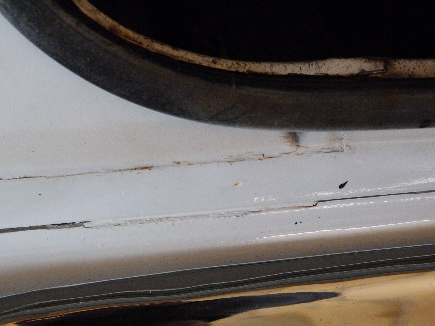

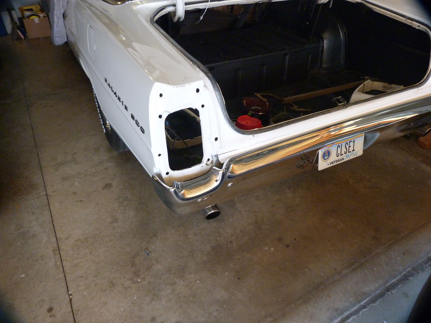

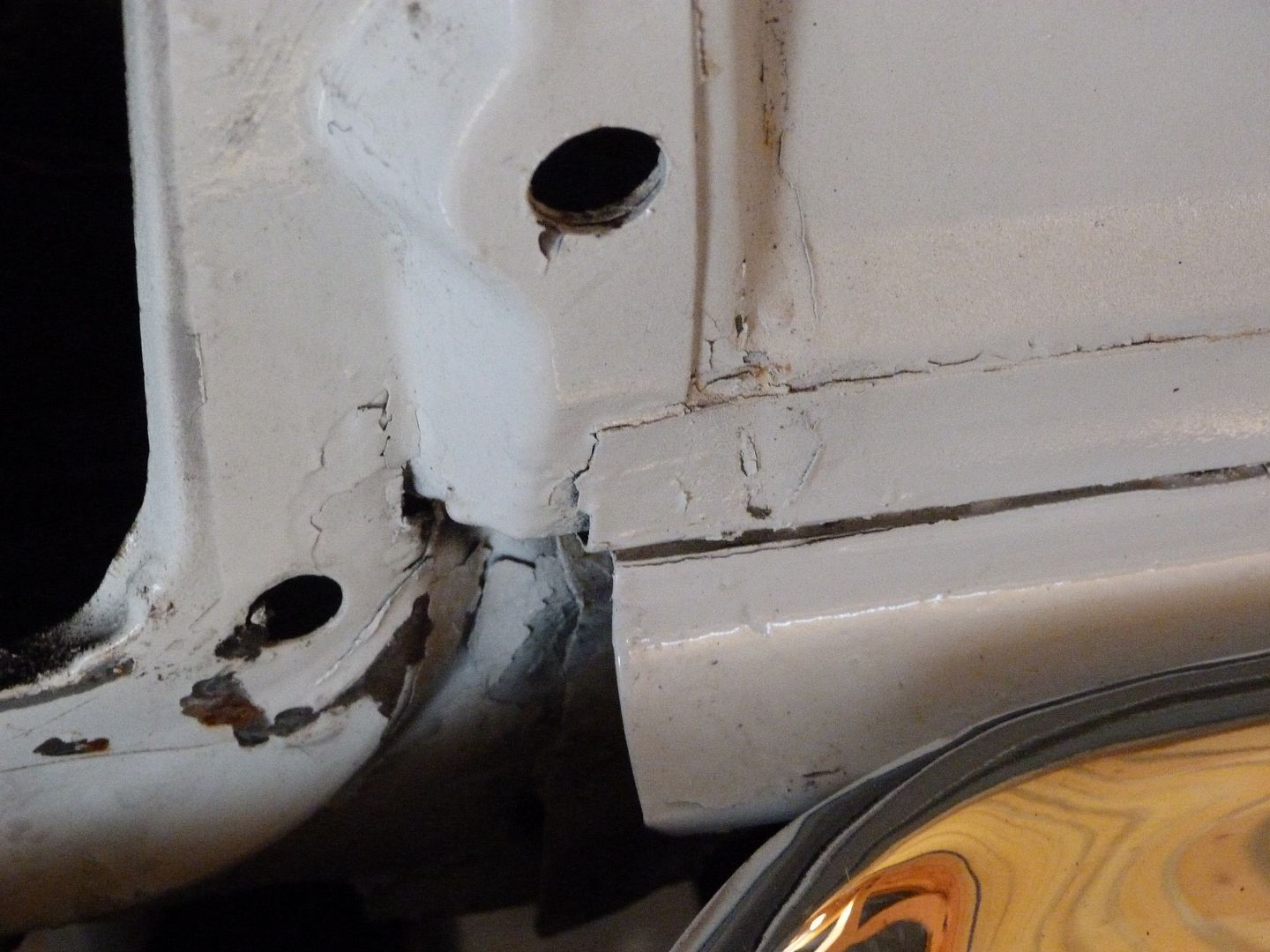

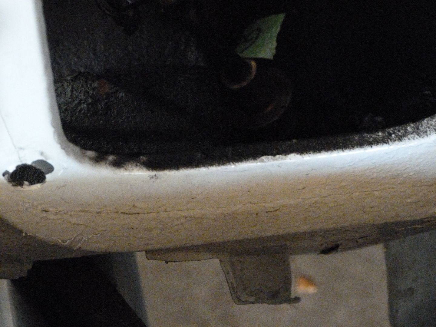

This shows damage car had in left rear. Notice the valance on right of picture. Someone welded strips together to rebuild a damaged valance. NOT good. Valance should have been bent from one solid piece of metal and bolted to rear wings. You can see the gap in bottom center. This is actually a hole into trunk!!! The metal behind that is supposed to be in the curve of the body colored housing. You can see the tearing etc. of the housing. I will attempt to repair this.
Closer look at valance strips. Rusting on edges.
Bottom edge of left rear quarter panel (wing).

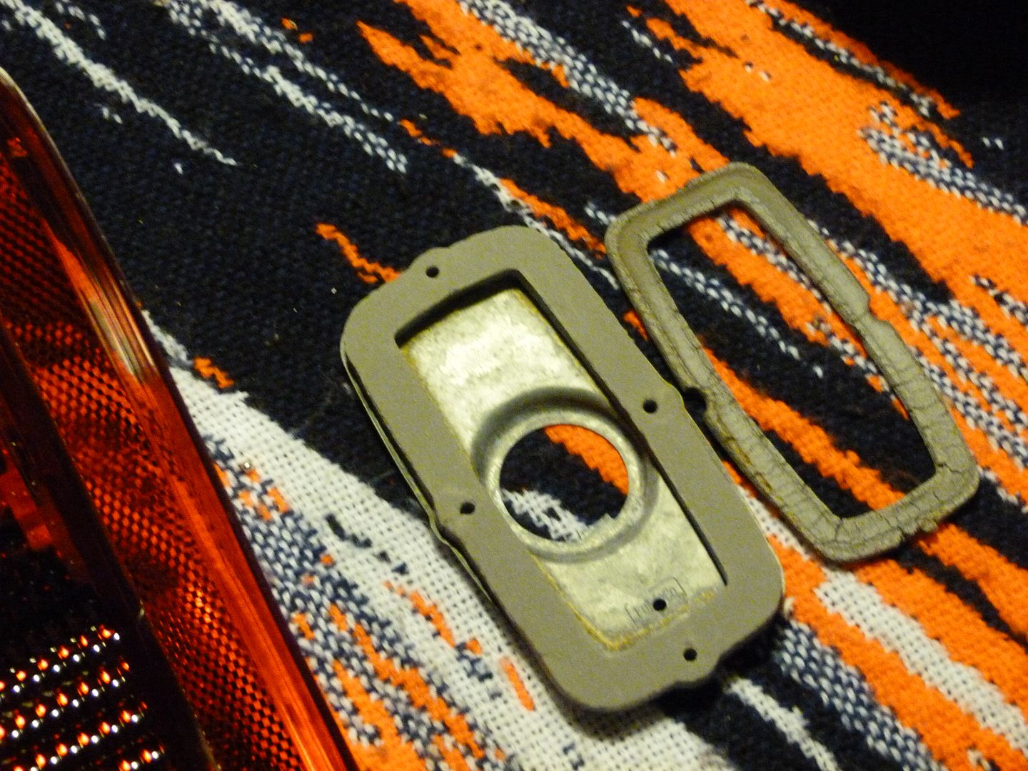

The three parts: Housing, reflector, and lens with chrome accents.
Weathered and dirty lens. Gaskets are all dry-rotted.

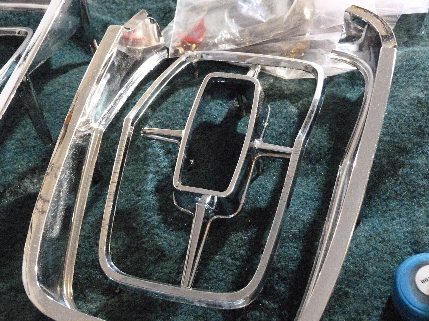

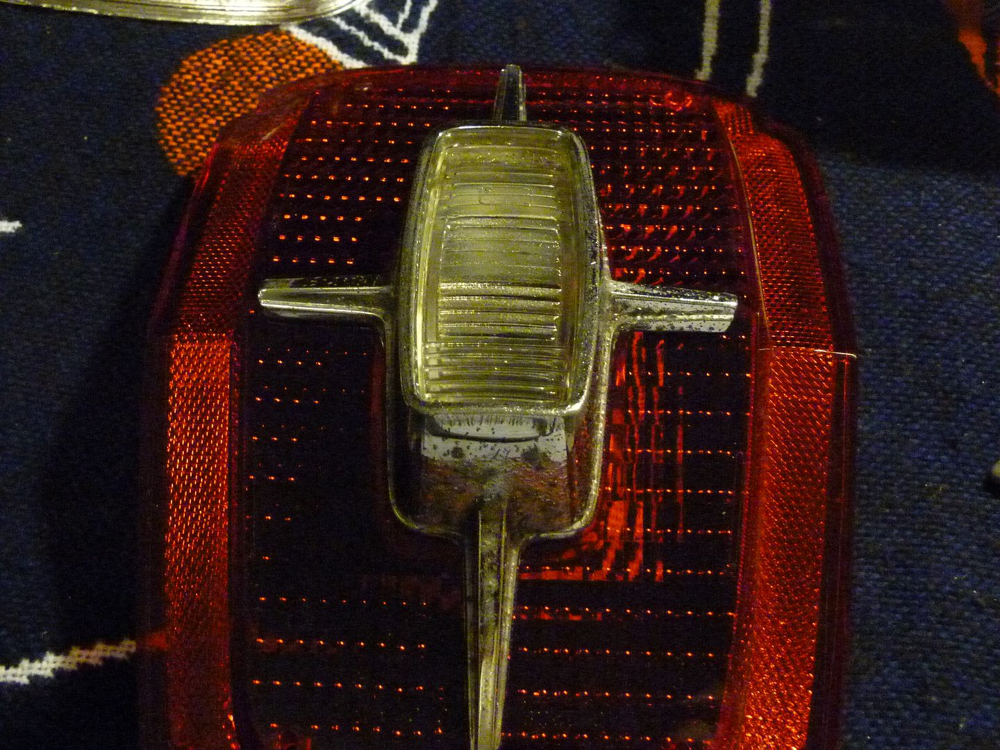

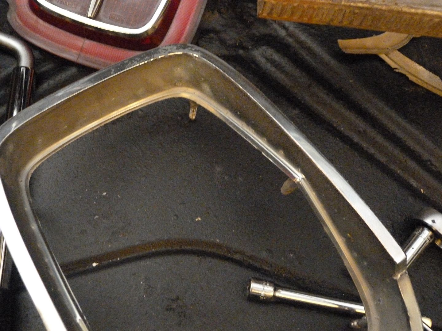

Outer Chrome surround. Corroded. Needs replaced or re-chromed. I will polish it best I can for now.

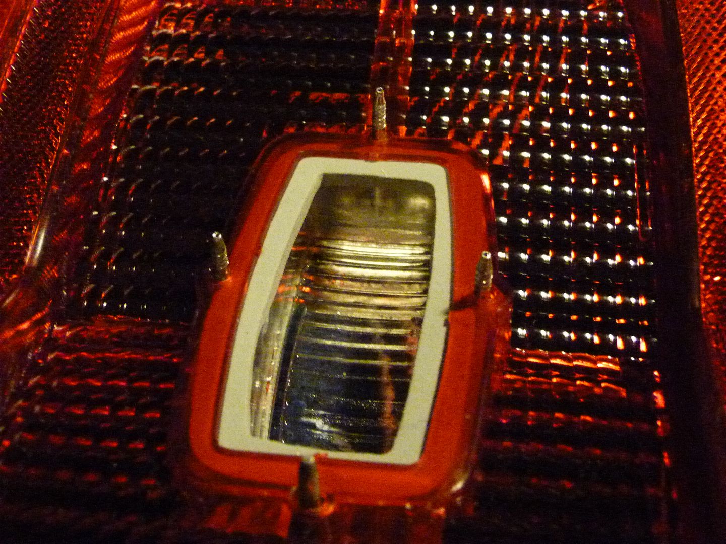

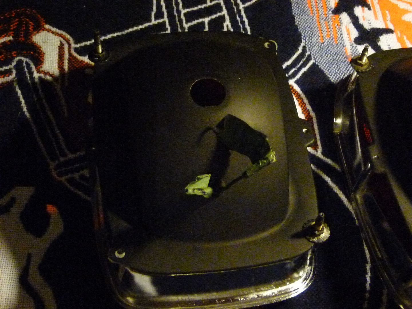

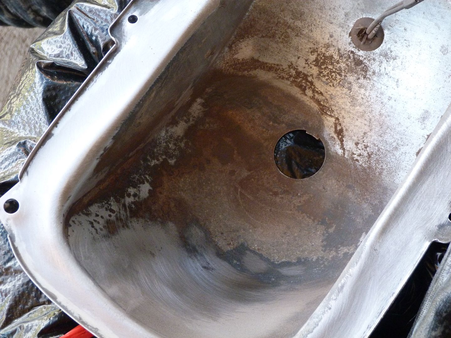

Water got inside reflector and rusted it. Left side of course.
I removed rust from both reflector bodies and sprayed interior with silver reflective paint and outside with flat black.

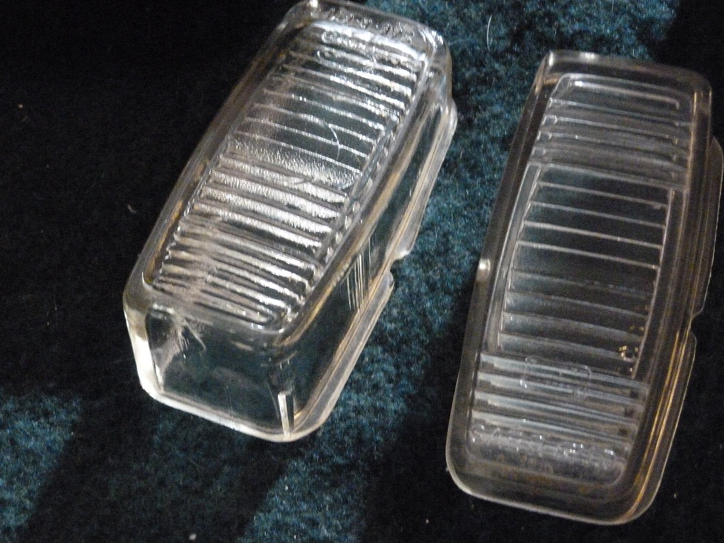

You may have noticed how "yellowed" the glass lens were. I cleaned them with paint thinner to remove obvious overspray. I then soaked them over night in denture cleaner, Efferdent. Good trick I found on net. It worked!!! Who knew??
Chrome polished the best I could achieve.
More severely pitted Chrome. Polished best I could.
End result of hours of polishing.
Ready for reassembly.
Parts laid out with new gaskets and new lenses. The other lenses were too faded and looked shabby.

Outside view of completed assembly. Looks better anyway.
