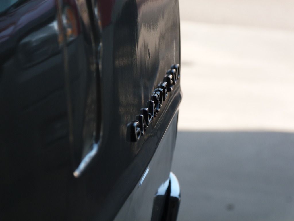

At a point today where I could take a few pictures. Remember the car was like this when I got it. The ex-owner had a Maaco paint job done. They spray any car for $399 USD! He had extra work done so he paid $3,000 USD! (He left the receipt in the glove -box along with speeding ticket for 105 mph in 75 mph zone. $300 for speeding and $750 for reckless driving) Extras: Holes filled. Rust on rocker panels fixed. Clear-coat (1 only) He got ripped off!!!!! Obviously an "American Idiot" (clever Green Day reference) Great album by-the-way!

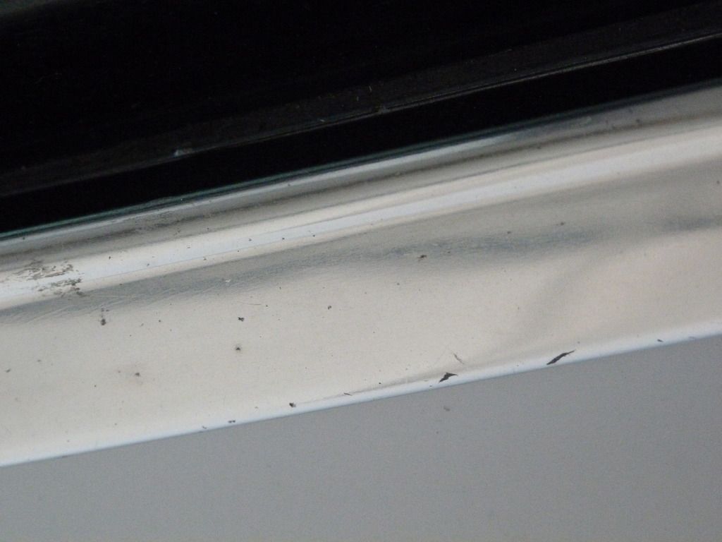

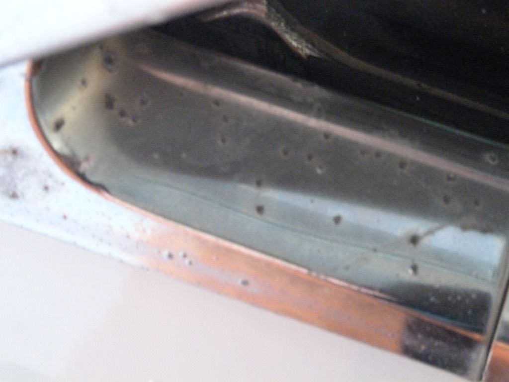

Dull and pitted aluminum.

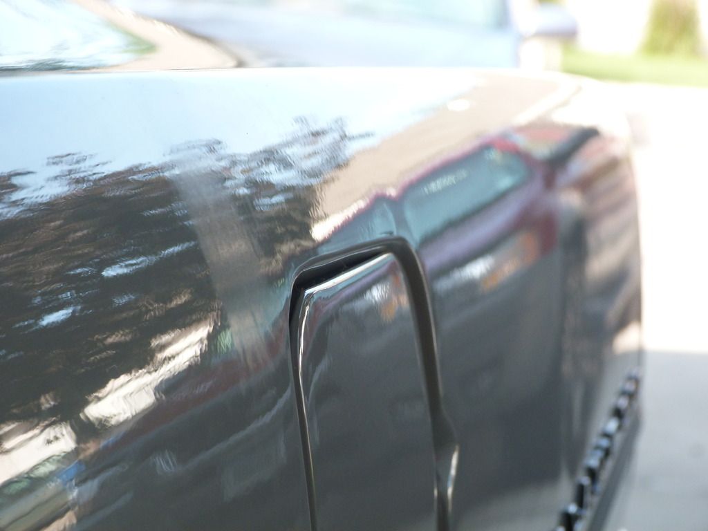

Chromed door handle. The driver's side looked like this before polishing. (See picture below). Notice when they taped off car they wound up painting the rubber gasket between handle and door. I have new gaskets.

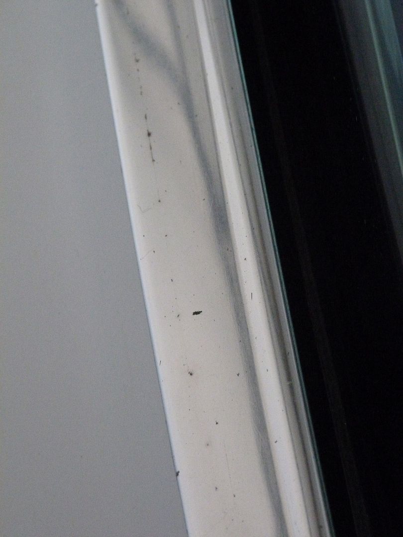

Chrome trim at the bottom, back corner of rear window. Needs re-plated or replaced.

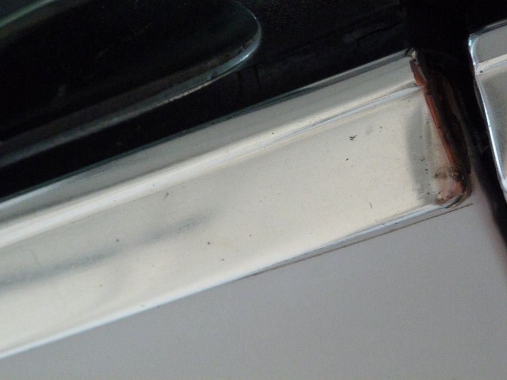

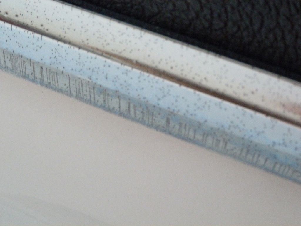

Chrome trim around rear, bottom of vinyl top, passenger side
Dull and pitted aluminum trim

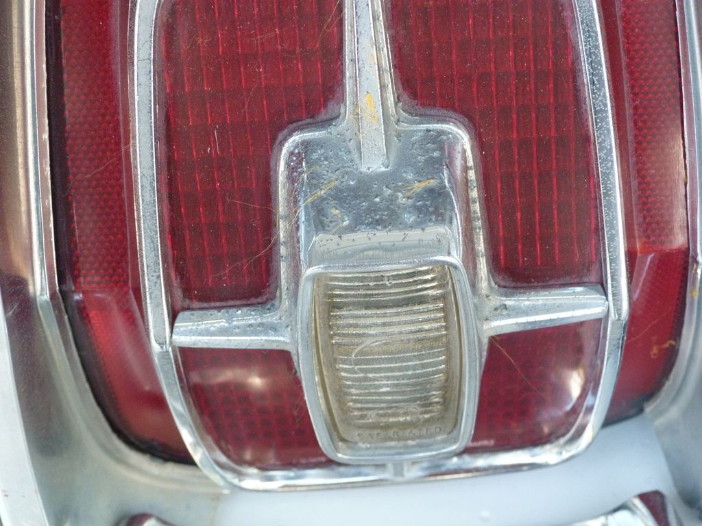

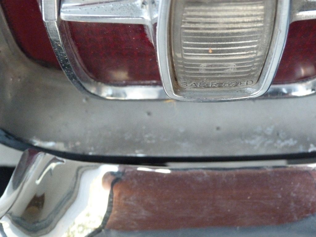

Driver's side taillight assembly. If you look below the piece you can see where painter's missed spraying the white. It's still the original light tan. Lots of bad chrome. I hope it can be salvaged and re-plated.

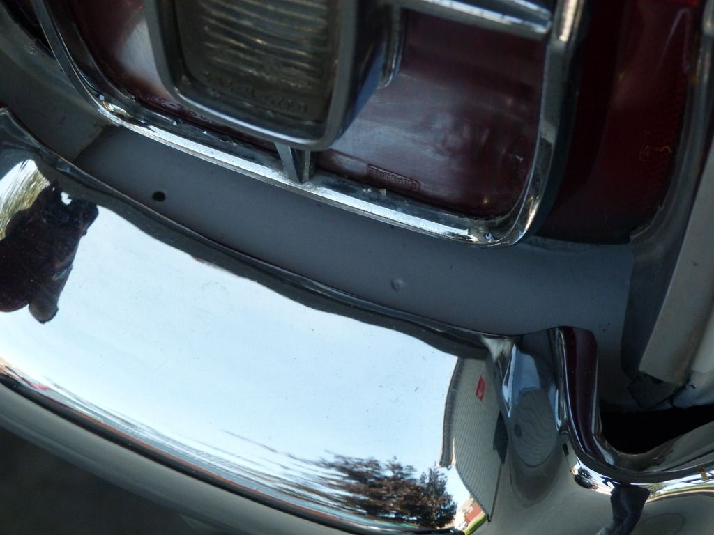

Passenger's side taillight assembly. They painted this side. Well, sort of.... The ice melt we use in USA is reason rear taillights are so corroded. I hope it can be salvaged and re-plated.
Also notice how faded the red lens is. I bought new lenses L&R.

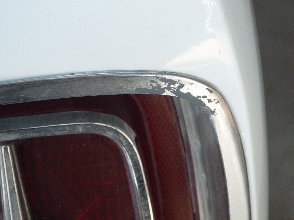

Peeling chrome.

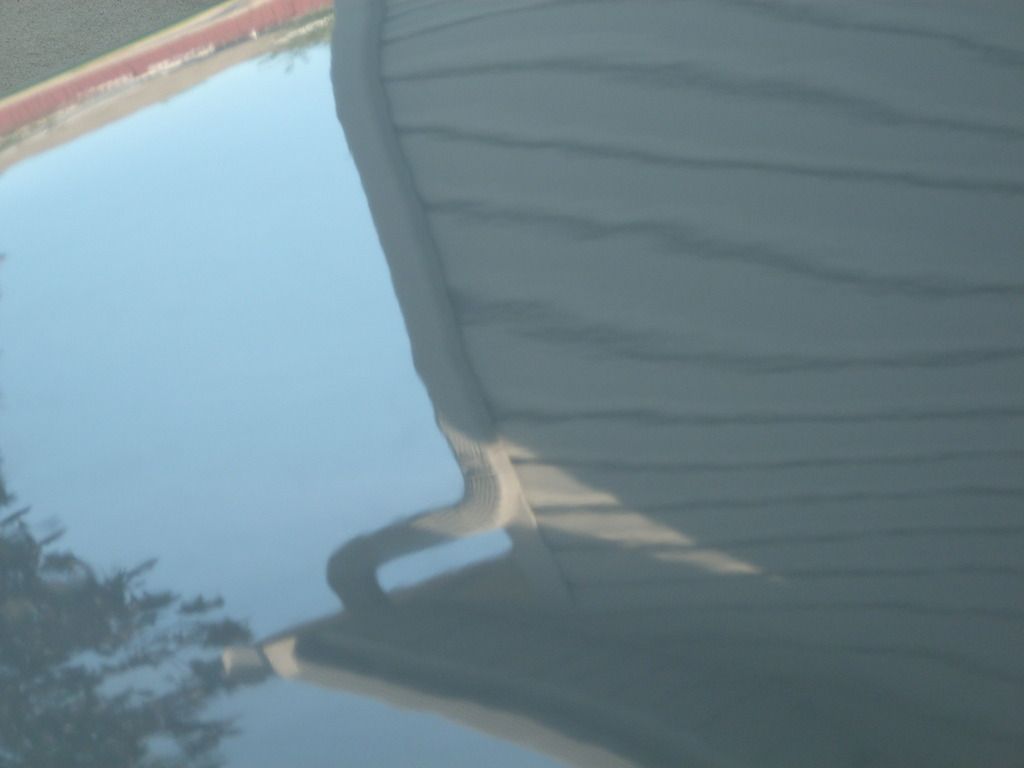

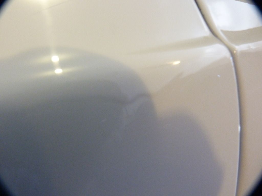

This is the driver's side of the trunk (boot) lid. You can see the distortion in the reflections. There is a low spot. I can pop it out with a suction tool. Never know it was there. I think left rear was in an accident at one time.

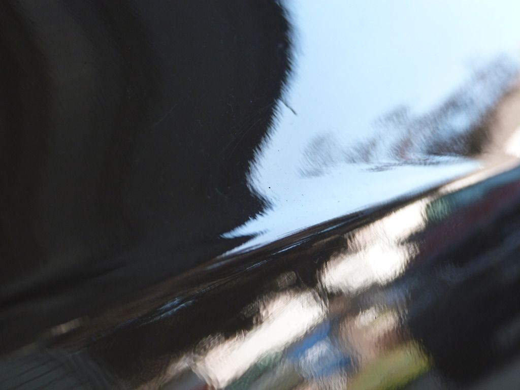

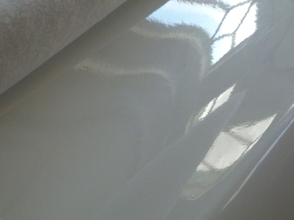

The famous "orange peel" ! This I will color sand out and buff to luster.
More famous "orange peel" ! Defect in paint. I can fix these.
Still more orange peel. There are other defects in paint if you look closely. I think I can save this panel with color sand and buff.

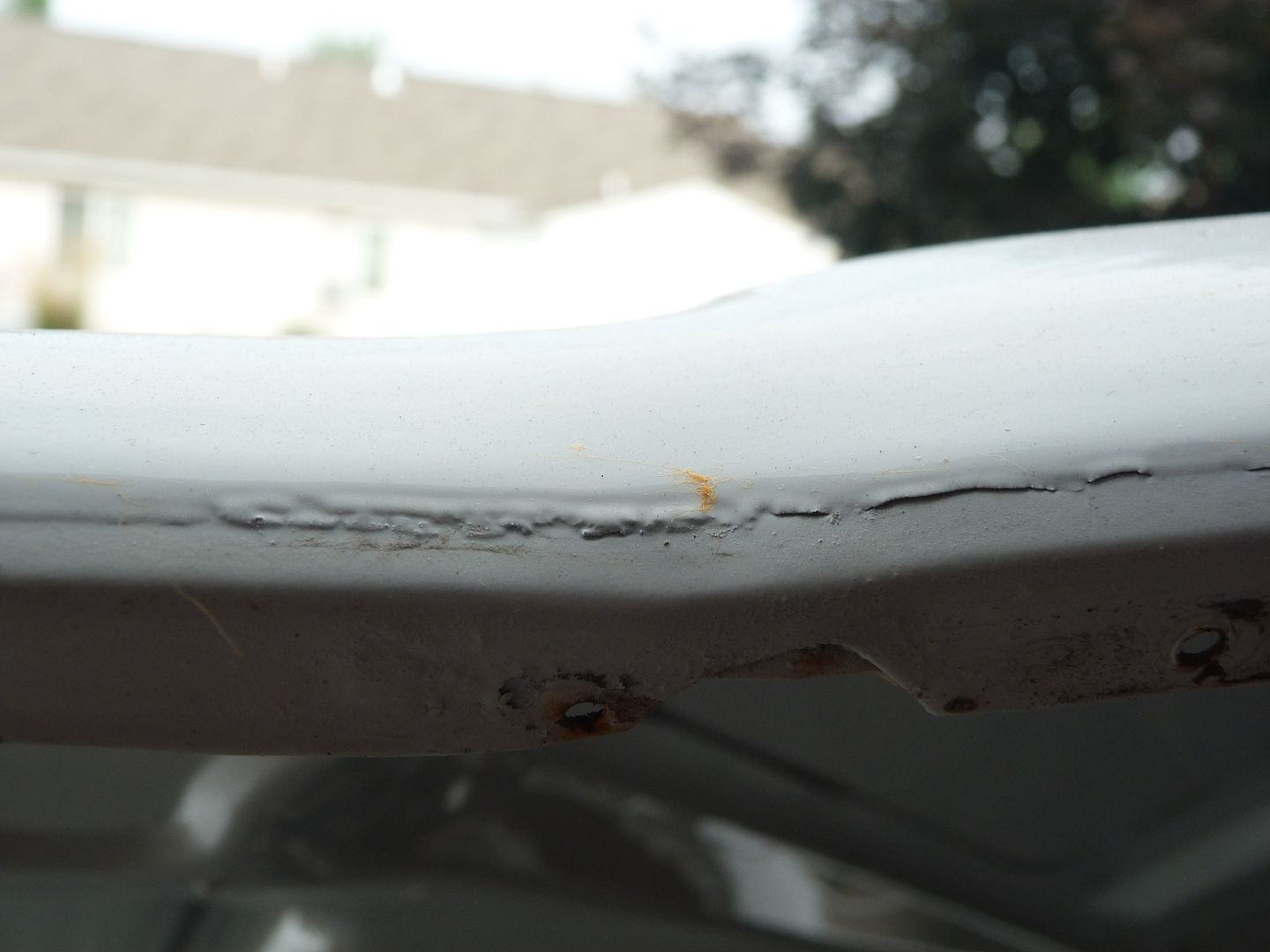

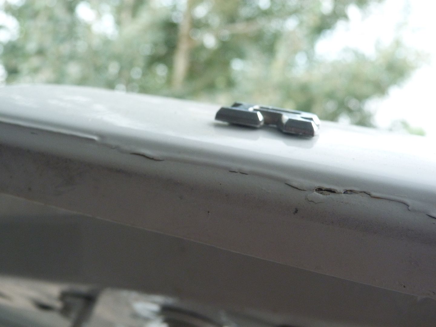

The front edge of boot (trunk) lid. There are some dents here. Their are bubbles along the edge of gap. The paint is going to peel. I'll have to fix this too.

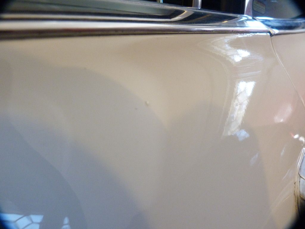

Paint defects.
Still more defects. See how many you can find. "Where's Waldo?" Notice on edge of aluminum, they didn't tape right and caused bubbles where there was a leak under the tape.

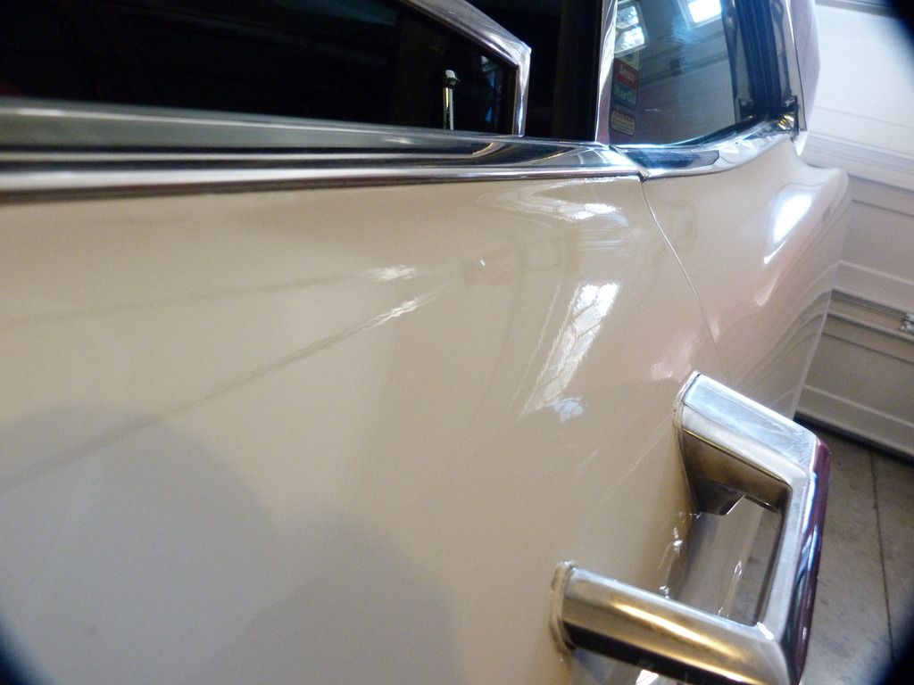

More paint defects. This door handle polished up nicely! (See pic of other one above) Painted gaskets again.

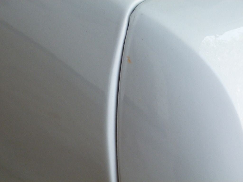

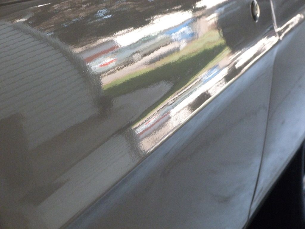

Here you can notice the light and dark vertical areas; these are waves in the paint, not the body underneath. (Thank God!) I think I can sand and buff them out. Thankfully that's because it crosses over the gap line. Never paint horizontal surfaces with vertical sweeps. The waves shouldn't be sanding errors, those probably wouldn't be across panel lines. With these Maaco guys who knows?

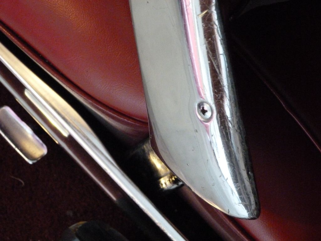

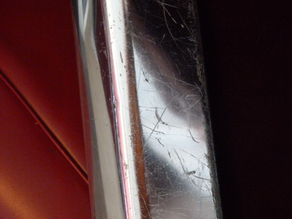

The seat bright work scratched deeply. From seat belts, dogs and/or people entering back seat. I hope I can save these. It's worse on driver's side.
Seat bright work. Very Bad!

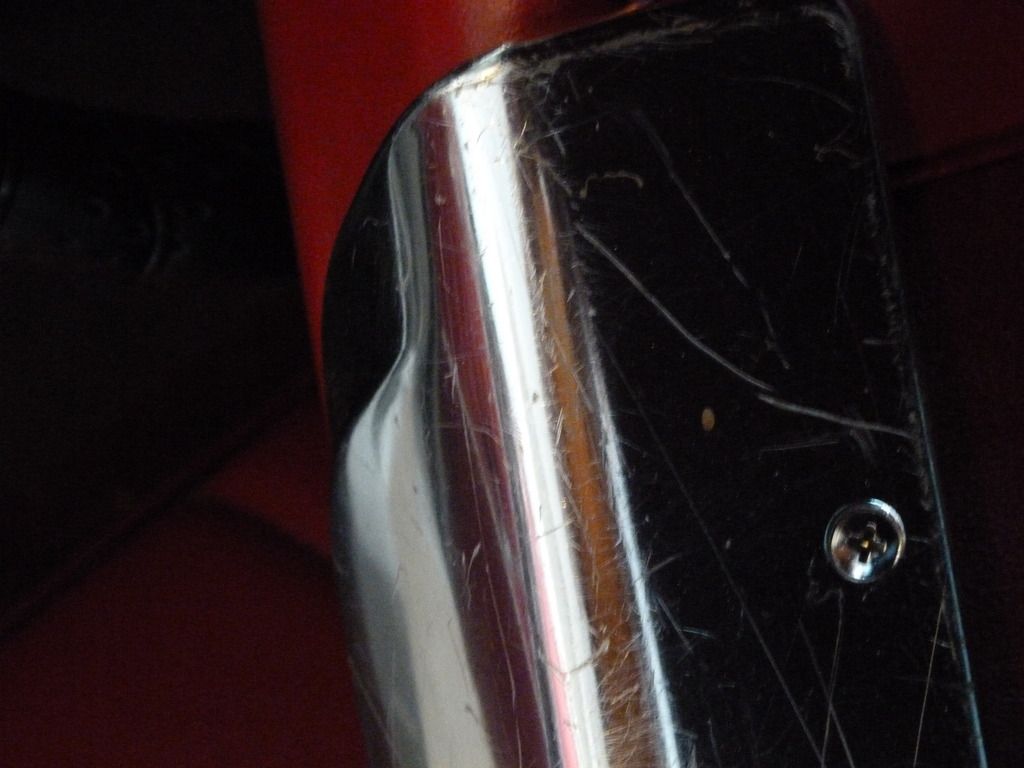

Seat bright work. If I can buff these (they may be chrome), it will be a lot of hours. Cross your fingers I can sand and buff these. Replacements will cost 1K+ for both sides!!! Ouch!

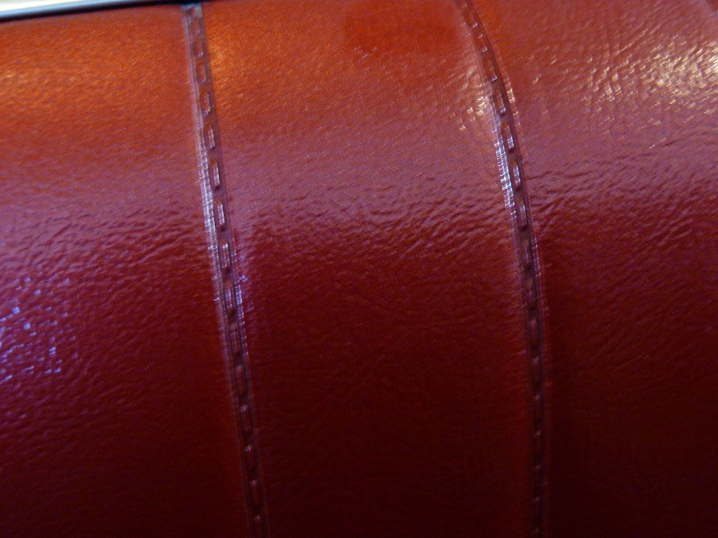

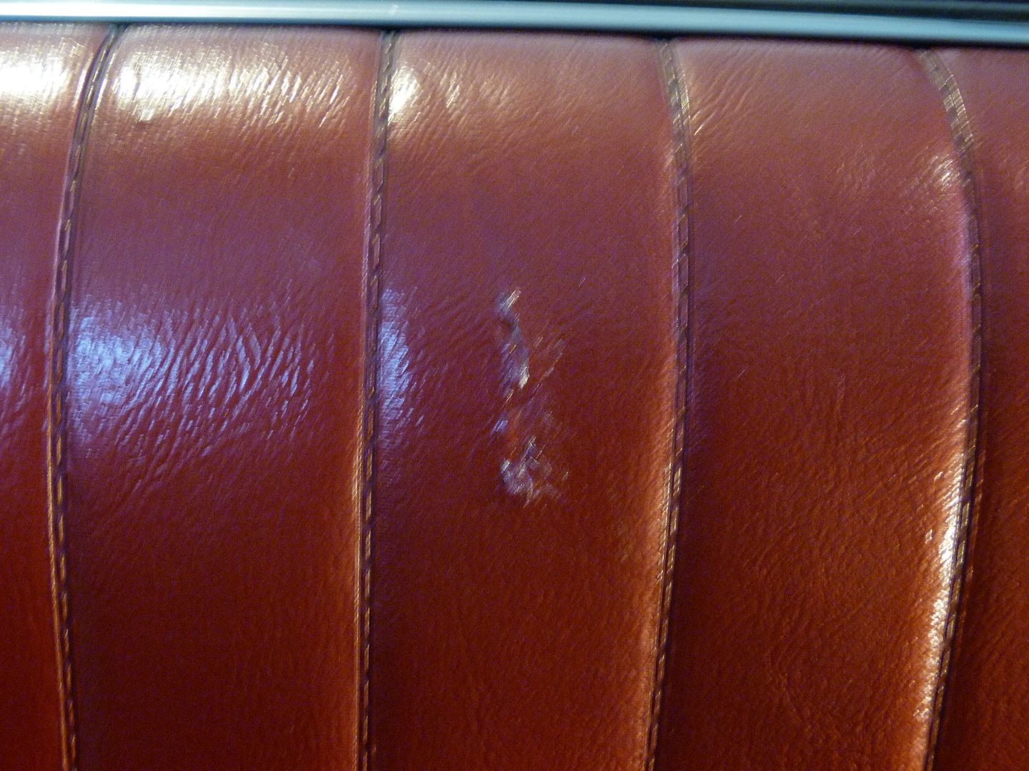

I took pictures of the vinyl tears before and after I fixed them .
This is a small hole in the driver's seat, before.
And after. It is almost invisible. Flash to light it up.
A little dark, but the repair is there. Can you find it?

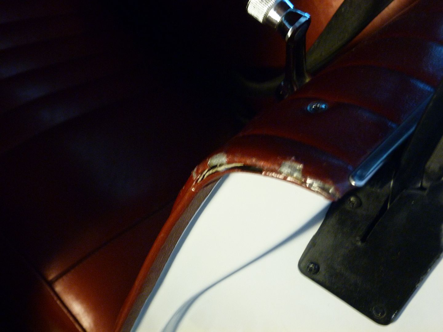

This is the entry to the back seat. People entering and exiting (probably snagging the edge) caused this damage.
A little dark, but it's repaired.
This is a tear I the door panel. I have already applied the glue to hold vinyl down. Next I put a mixed red and blue (maroon) vinyl and applied to damage. Then I took a "grain relief" paper and used a hot, flat, metal tip to iron on the grain.
There was a tear in the door panel. Key word was. I bet you can't find it.
Anyways, I fixed 11 different damaged areas throughout the interior. They all look very good considering I'd never used the product or technique before.

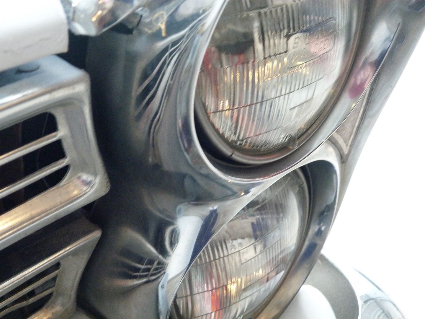

Driver's side headlight "bucket". It is chrome and it is really not up to par. I will have to have it replated.
Ditto for the passenger's side bucket. You can see the rust on the front grill.

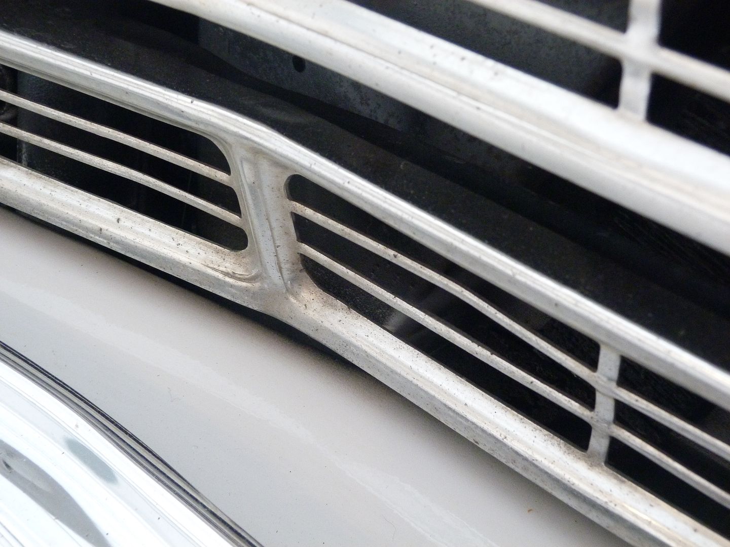

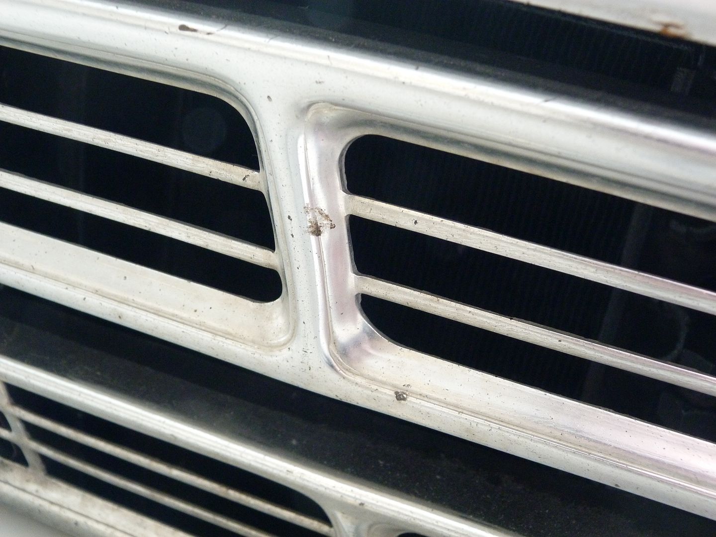

A couple of shots of the front grille. There are at least a thousand points of damage. Some are small. Some are large. A project I am avoiding like the plague! I figure 50 hours minimum. :cry:

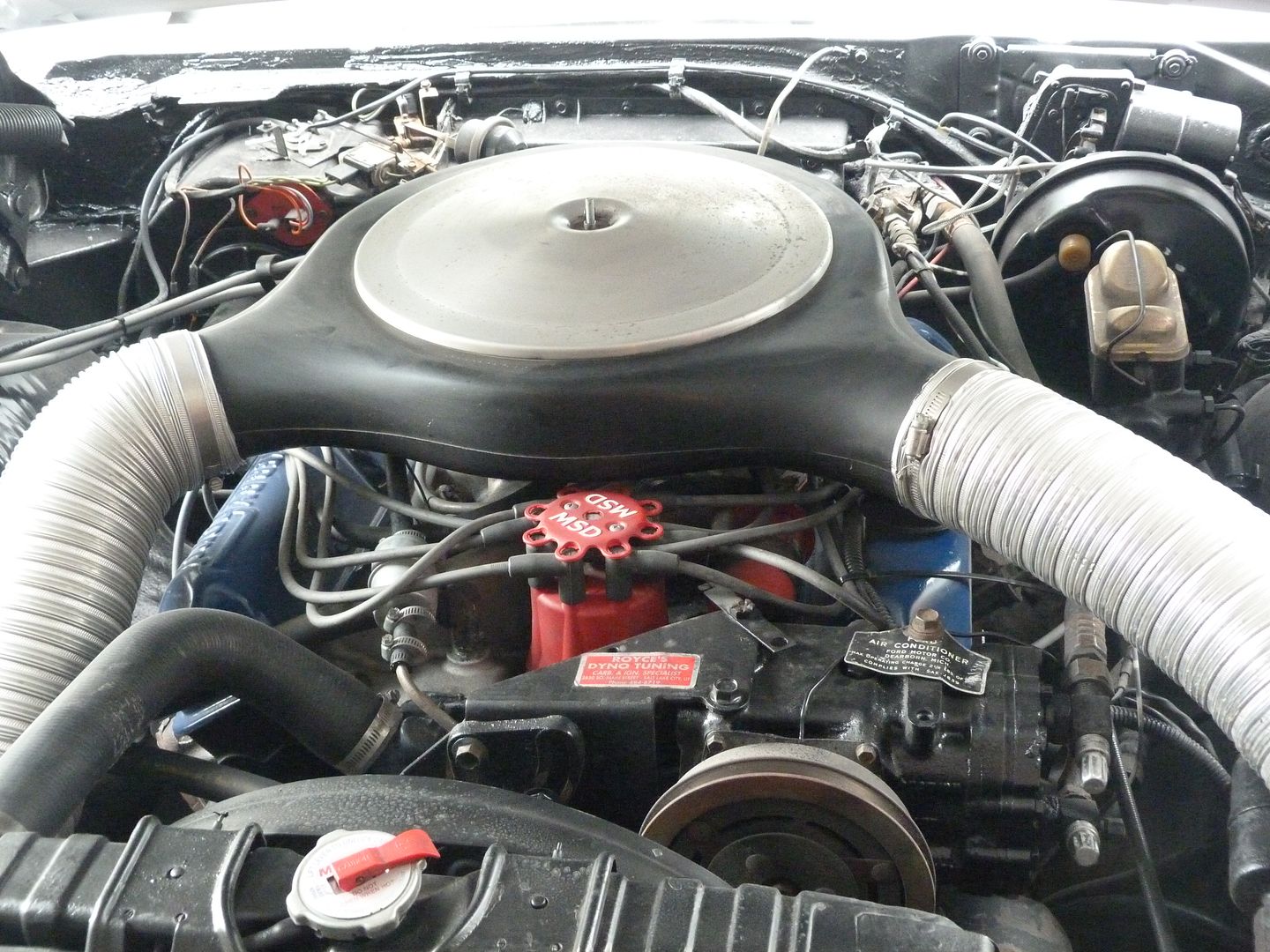

OK, Mark asked to see the engine. Obviously not restored. The previous owner got the air cleaner off a wrecked 1964 Ford Fairlane "Thunderbolt" drag car. The cheapo ducts are clothes dryer vent tubes. It's supposed to give a cold "ram air effect" to the carb. On the Thunderbolt the tubes went to the inside (It had side by side lights) headlight bucket with the light removed. Must have worked, as the Thunderbolts dominated the 64 and 65 Super Stock experimental division. I think I want the engine bay to be "stock" looking with the correct hoses, clamps, air cleaner, Ford "Motorsport" valve covers, drive belts, and all the factory "correct" decals. The wiring needs to be "cleaned up". It currently goes Willy-Nilly all over the place. I want to run it in the proper wiring looms and brackets.
Front view.
Passenger's side.
Driver's side.
