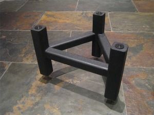

Well these are the stands I built for mine:
They are thick wall steel and the uprights are filled with lead shot - intentionally they have no top or bottom plates. In the picture they show top spikes but I have since moved to a different top mount method - essentially a kind of rigid ball and cup arrangement.
By having different lengths of Delrin puck it allows the speaker to slightly tilt back by a couple of degrees and this helps to time align the drivers (the ball bearings are 12mm stainless steel but I keep meaning to try silicone nitride or Delrrin).

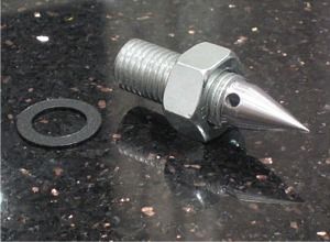

I wasn't happy with the M6 spikes generally sold for floor coupling so made some very much larger ones (M16 I seem to remember).
Your proposed mods sound excellent to me :).

Your stands are amazing. But way beyond my metalwork skills and tooling.
Do you mind me asking way you didn't cant the stands back by adjusting the spikes rather than variable height ball bearing sockets ?
Also do you reckon box section filled with shot is preferable to solid bar? I could get my hands on some 63mm solid aluminum bar. So wondering which route might be acoustically preferable.
I would value your and other thoughts.
Posts: 3579
Re: Welcome - Say hello in this thread.
Post by YNWaN » Sun Oct 25, 2015 11:09 am
Hi David,
Sorry if my responses are a bit short - at the moment I'm away visiting family and the interconnect connection is a bit flaky :(.

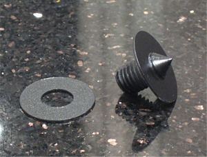

Two reasons for the way I chose to tilt the speakers back. 1/ although I made the floor spikes with a lot of thread I don't like too much of it to be exposed as it reduces rigidity; the same applies to the top spikes. 2/ I prefer the security of connection that my chosen solution provides. The contact are is clearly defined irrespective of the angle chosen and I like the slight mechanical diode effect of the Delrin and ball bearing construction between the speaker and stand. I also made more traditional top spikes and preferred the Delrin/ball solution.
I specifically wanted there to be some mass in the stands hence the use of lead shot filled steel (I don't have the gear to weld aluminium). Solid aluminium uprights should work well though and I see no reason why you shouldn't use them (though I also like your other proposed construction).
Original top spikes:
Floor spikes (these are quite a bit bigger than the photo may suggest - 16mm in diameter):

Mark,
Thanks for your comprehensive reply. I think I've decided on 3" aluminum tube .25" thick with m16 threaded bar bolted top and bottom filled with lead hot. Should be fairly massive and solid. Would you consider a commission on the ball bearing angled arrangement. As I really like the sound of that as I can then true up the stand knowing the angle is given by this method. My m8 spikes can be shortened too which would be a good thing. Given my Interface is wood on wood, I would need to either cup the speaker stand top plinth or have a further Delran cup plate? Any thoughts and would you be up for such a commission?
