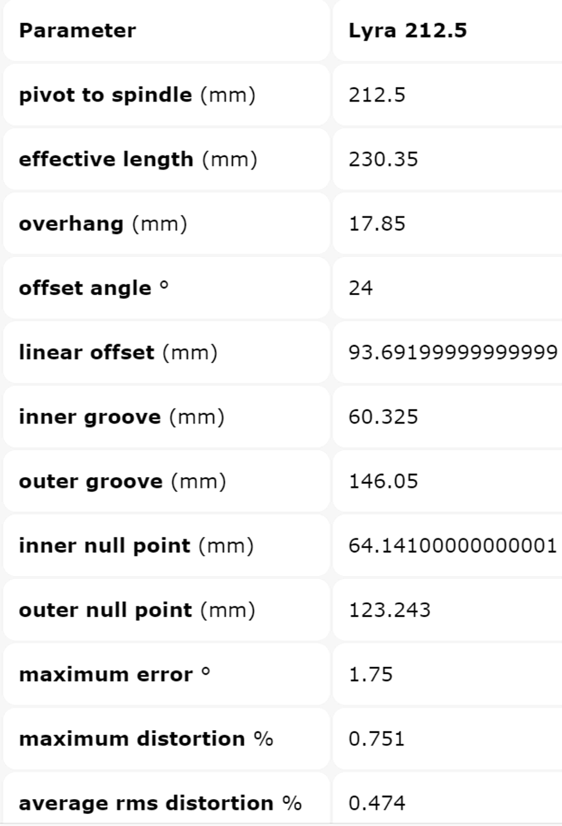

If it's not too much trouble, could you also try out the 9.5mm Lyra geometry at 212.5mm?

This is for the Lyra:
If you change the pivot to pivot distance to 211 the minimum distortion goes very low but the distortion at the beginning and end of side goes very high.

Thanks, Mark! So the Lyra/Greenstreet combo is indeed just about spot on...

Yes, I would say so.

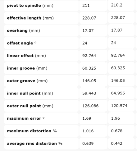

This is the Troika at 211mm and 210.2mm - you can see the trade-off that exists:

Actually, 210.5 or 210.4 seems to be the absolute optimum for the Troika, but very little in it even at 211mm

There's no free lunch with a 9" arm is there? I'd always bias towards lower end of side distortion.
